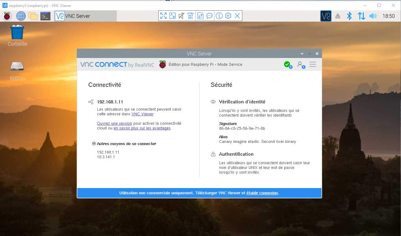

EDIT:j'ai naïvement lancé un diagnostic via la fenêtre de VNC, et il me dit:
VNC server appears to be behind a NAT router with IP address 94.XXX.XX.196. You will need to configure that router to forward port 5900 to this computer befire you can establish direct connection to VNC server over the internet
